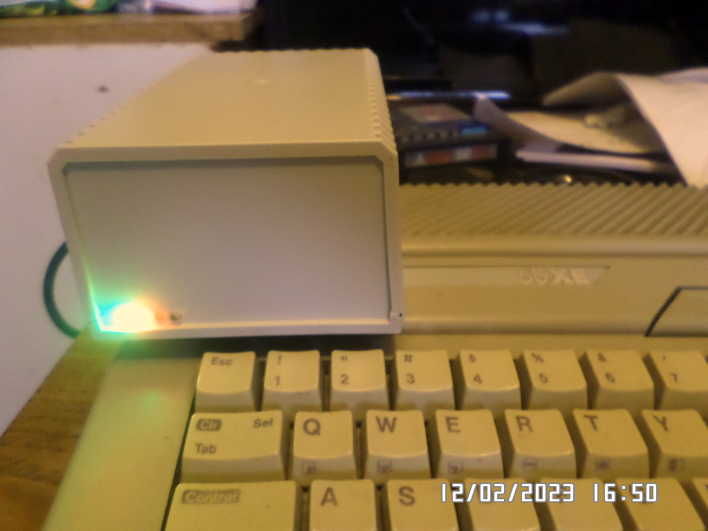

von Sikor » Di 30. Mär 2021, 19:39 Sorry for google translate again. I put here copy my post from atariage.com: Ok, I have SUPER SIO SPLITTER tiles for constructors - if they are willing. So far, there is no housing, which is currently being drawn. Now yes - the boards are in revision 1.0, the construction will not change anymore. There will also be a batch of boards in the 1.0A revision - improved ground area under one connector, change in the size of the holes for the SIO (slightly larger), change in the size of the holes for the power socket (slightly smaller).
I will be able to send the PCB (for registration) after April 10 - I have to refine the documentation. This is a very short series (25PCB), revision 1.0A will also be short (25pcs too). Therefore, I am introducing a limit of a maximum of two pieces per person (I can send a collective package to reduce costs), basically these tiles will be sold at absolute cost - but with the possibility of issuing a Polish VAT invoice. The order of entries decides about the possible purchase, and I intend to sell the developer versions (those in the pictures) in two options: 1. PCB + 3xSIO, without other elements: PLN 60 or USD 15 or 12EU 2. PCB plus all elements (except POWER SWITCH, which is optional): PLN 75 or USD 18.75 or 15 EU The prices listed do not include the cost of the courier, priced individually (in Poland, delivery via InPOST, in Europe, delivery by post).
Now the formal issue: I assume that device designers can use the soldering iron, hence the shipment as a kit for self-assembly. The PCB will be sent as OEM for now, i.e. only a box, components (of your choice), a diagram and a registration card for developers - this should be sent back to me by post, so that after producing the enclosures, I can enjoy a new enclosure for my own set (I expect the end of this year). All registered designers will receive the housing and full printed manual at absolute cost.
What do I expect in return? As this is a promotion, I hope to: - performance of reliable tests - development of new devices in the standard offered by PCB - unapproach the device on the forum;) If anyone would be interested - please write to the e-mail (please process it properly): biuro at sikorsoft dot waw point pl in the subject, write "Super SIO Dev Board" and specify the quantity (1 or 2) and the selected option (1 or 2). The order in which the e-mail is received is decisive. Photos are on atariage.com
Heute habe ich die endgültige Version der Gehäuse in Empfang genommen - es fehlen noch die Sockelbeschriftung, das Löten, die Anleitung (bzw. die entsprechenden Änderungen daran) und die Verpackung. Sie können sehen, wie das (fast) fertige Produkt aussehen wird. Ich frage mich nur, ob ich die Boxen bereitstellen soll, oder ob Sie ein billigeres Produkt bevorzugen würden (die OEM-Version, nennen wir sie)? Ich habe Bilder auf Atariage gepostet: https://forums.atariage.com/topic/314342-supersio-splitter/?do=findComment&comment=5152719
